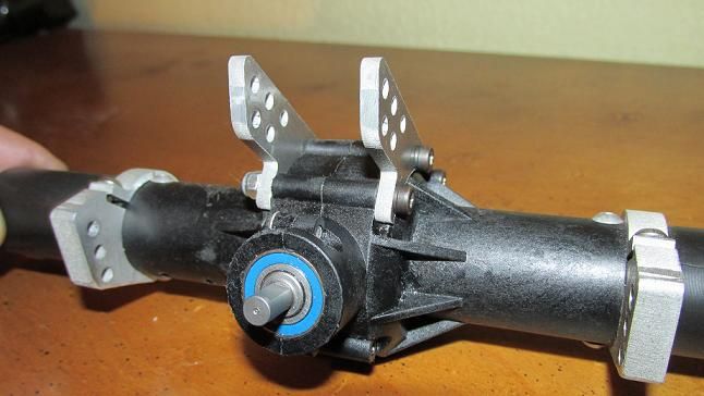

so i took Rick's idea and took out the bottom screws in the housing. the only problem is if i where to just shave it down until it was flat, it would be paper thin. so i took my soldering gun and melted the ribs flat, filling the screw holes. then sanded it smooth.
i will leave the gussets alone for know. but i will most likely have to shave them off too.

reworked the link/shock mounts to get a little better clearance. just need to do the fronts know.
went back to the narrowed ax10 wheels. gutted them and got some Hulksta CF front plates so i can run VP hubs.

a little rework on this thing.
changed the upper links in the rear.
shaved the housing so the shark fins sit tight to it.
the links are just aluminum. thinking on a good fall they wont last with those kind of bends. will have to save up and find someone to make them out of TI for me.
