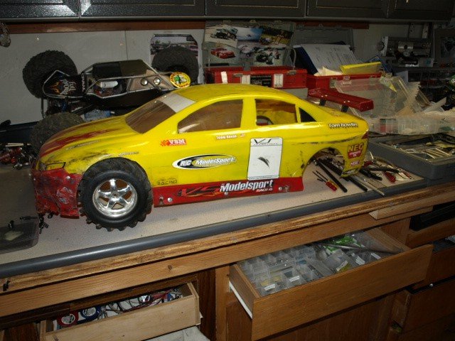

1/5 scale Sedan Body- free

Any recommendations on What:
ESC
Tires -
Brushless motors Just bought a Feigao XL 2383kv about 7 turn
Voltage
When I get another job This car will be OVERHAULED with 10x better parts like a Xray center diff, Neu 1515 Motor, Better HV ESC, Steel shafts, new suspension and so on.

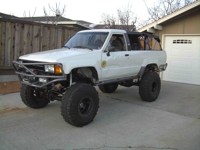

the action is cool my 1:1 wheeler/crawler gives a flavor of drift if I hit the gas at the right time and turning at 40mph
The suspension is Amazing, on the rocks it's soft and flexy
:-P

Well at least now I know I'm not the only one who gets their 'Yota sideways. My friends think I'm crazy because I actually can do a donut (Neither of them, one with an M3, one in a Corvette could get one done in a wet parking lot)

cool , well just dont hit a pot hole and roll-over eah
my First was a 86
1992-1999
dam tough truck

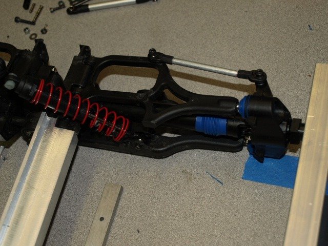

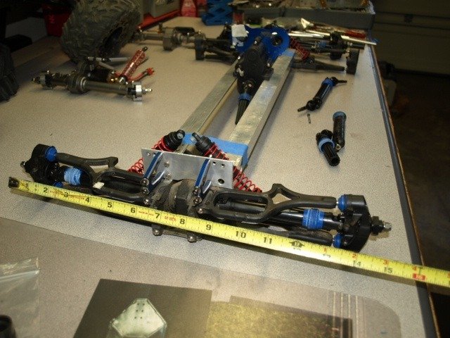

BACK to the build:

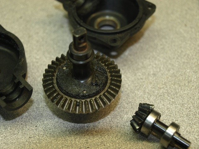

Dissembled the Axle centers and cleaned the gears , bearings and some new bearings
Installed str lockouts for the rear
Made some Aluminum brackets for the top of the carriers
Next is the Chassis pan .080 2mm T6 Aluminum

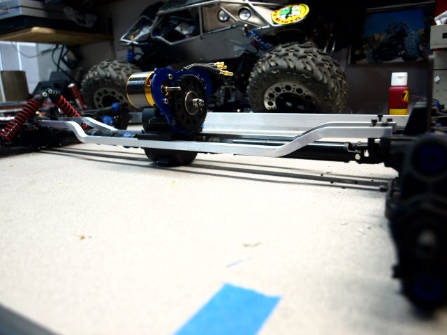

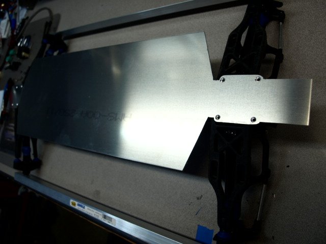

Changed my frame rail design
1/4 6061 Square with round inside tube
Always double check measurements, I bent and cut the rails thinking the wheel base was 21 but it's actually 20.5" so some help with Trigonometry the rails where bent down ward to reduce the .5" which turned out to lower the tranny to the bottom :-P
Chassis Pan next:
Carbon fiber pan would be nice and $$$ so I went with Aluminum T6 2.5 mm 6" x 27"

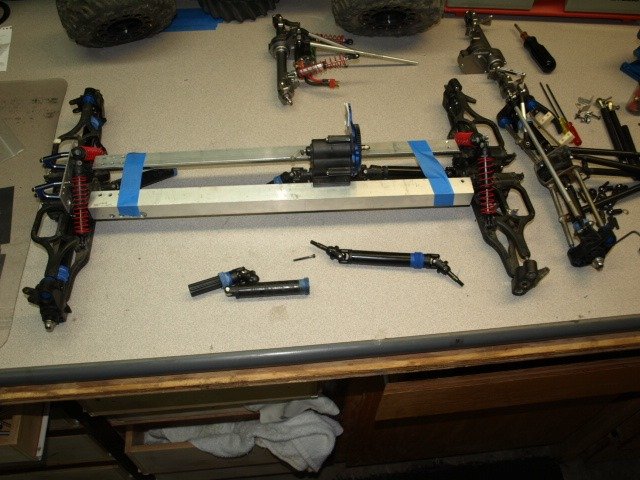

Finished cutting out the bottom main chassis 2.5 mm thick 6061 27 x 7
Made some Shock towers, might need to go taller to lower the chassis though
also redo the shocks with 50wt and reduce travel and Integy hard springs
Still need to bend the Aluminum sides up a little for extra strength
Need a Foam bumper. some ABS plastic,
Going to Design some Anti sway bars
Bought some 1/8 scale steering, will go in next
Still looking for Wheels

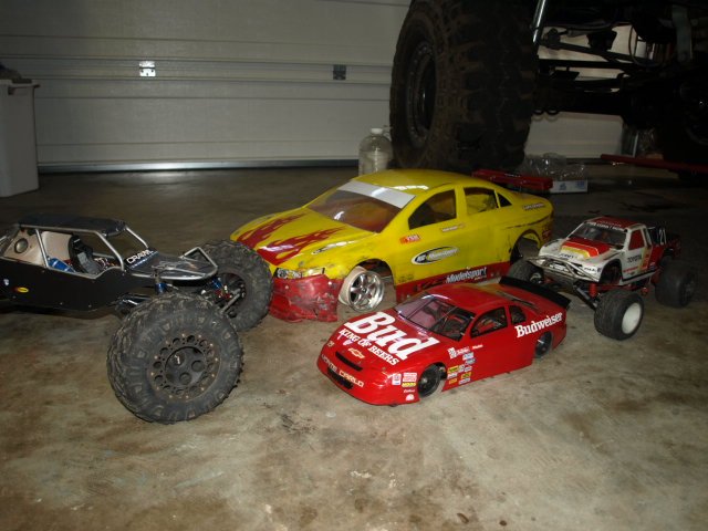

Here's a little Size Comparo
My Super crawler 18 and old RC10ls and my modified RC10 /B3 baja
