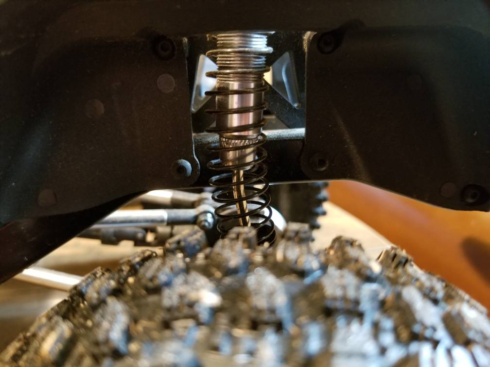

Noticed my first breakage today. Left rear shock shaft is bent. Looks like time for shock upgrade now.![]()
Sent from my SM-G950U1 using Tapatalk
What shocks did you decide to go with?
