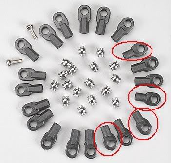

And these are the only Traxxas rod ends I could find that fit the losi spring cup. They are the 4 that come in the #1942 rod end set.

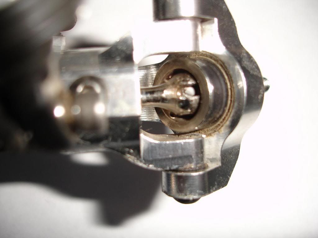

Todays breakage. 2 Axial CVD pins:x. I was not even in a bad bind at all when these broke?????The pins are what scared me the most when I bought them, They are only .059" thick.:shock:

Yea, I just broke another one when I got home. I got my dig finally setup and working and I went and tried it out and then, SNAP, another one broke:x.
Now I dont know if I can make it out there tomorrow. I need to go to hobbytown and pick up some more spare pins before I come out. I also need to get 2 more battery's. One of my battery's wont take the charge anymore. so If I come out I wont be there until about 2:00 or so.

The Axial cvds are a great design, i love mine, but the smaller pins are a weak point.
