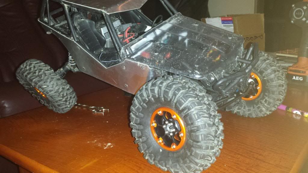

The carter fab panels are fantastic. So glad I decided to purchase them. They look even Bete with some trail rash now :) love them! Just need a matching hinged bonnet/hood.

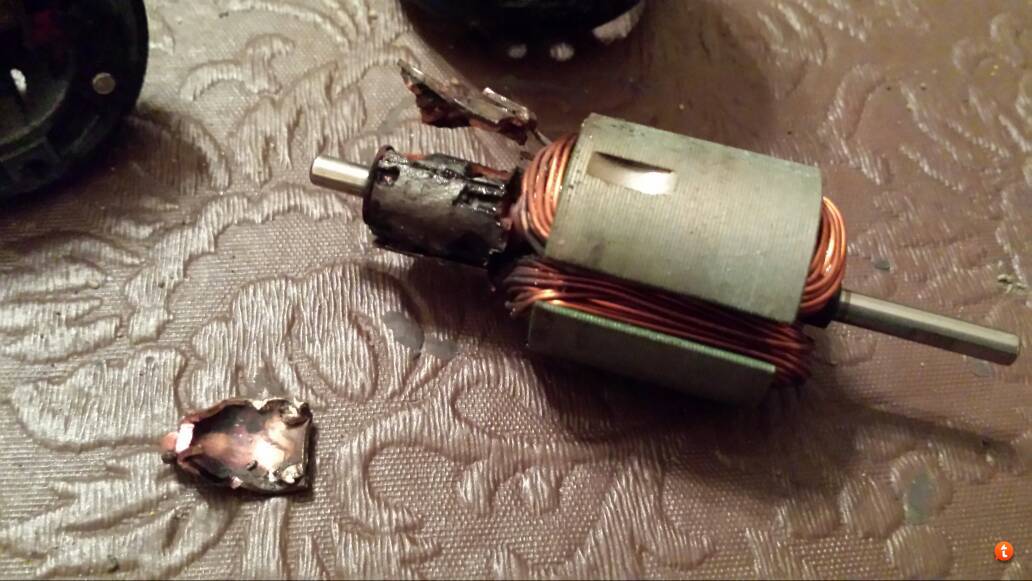

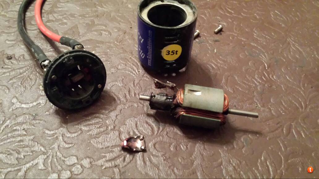

Ok so onto about the 6th battery pack and it's broken already.
Fault is the steering still works fine but the throttle does nothing (and it's not a flat battery).
Happened on and off but the last time (3rd time) it's done something worse.
The drivetrain is locked up, the motor will not turn and it smells burnt.
Another fault is the ESC does not beep when connected to the battery like it used to.
Am yet to pull it apart. Wanted some opinions before I go contacting the supplier of suspect bits.
It has been run in water up to about 4 inch deep, but not much.
The motor and ESC combo are Torquemaster Expert 35T and BRXL waterproof.
Battery packs are 3s Turnigy 2200mah (40C).
Any ideas on what's wrong and why? I certainly can not afford to go replacing motors every handful of uses :D

sounds like the motor is toast..water will cause very accelerated wear on a brushed motor, particularly with the brushes and com bars...also if its being run full throttle or near it for extended periods of time, that will also cause very rapid wear..it happened to my 27t torquemaster sport. I was able to revive it by lightly sanding the com bars and brushes until I get replacements from Homes Hobbies..

Thanks for that, seems I might have to take more care.
Does the above still have an effect on the ESC not giving the warning/binding beeps on first power up? Or could the ESC also be damaged?
When i toasted mine the esc did not beep at all...the led on the esc was blinking weird and not normal...after cleaning the brushes and com bars it worked fine after the first couple of trigger pulls...take it apart and check it...its really easy to do...just make a note of where the timing mark is on the case....it should be at zero unless it was advanced...there is a 0 marked on the edge of the case where the endbell meets...there is a slot mark on the endbell that should line up with the zero...
Hey guys just letting you know your esc dont make the beep sounds. Its the motor that makes the noises. The esc sends power to the motor in such a away and it makes the noise.
What you beleive would be the main cause of this considering the relatively short life span?
I have already ordered another motor. But would like to follow up on this one to have as a spare.

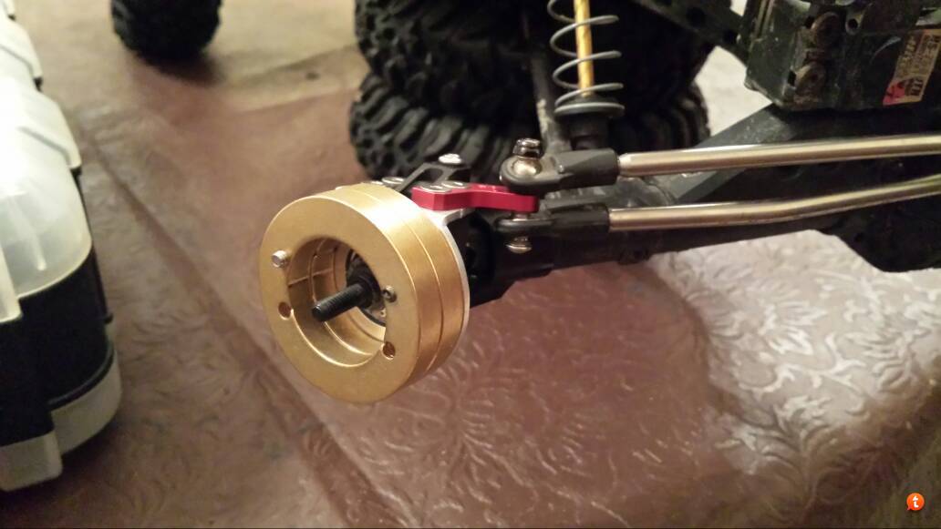

Now has Vanquish Chubs and Knuckles, with weights fitted!

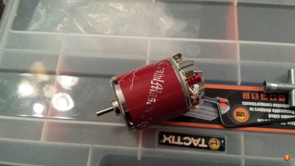

Crawlmaster 16T is waiting to have the leads fit then installed. "thumbsup"

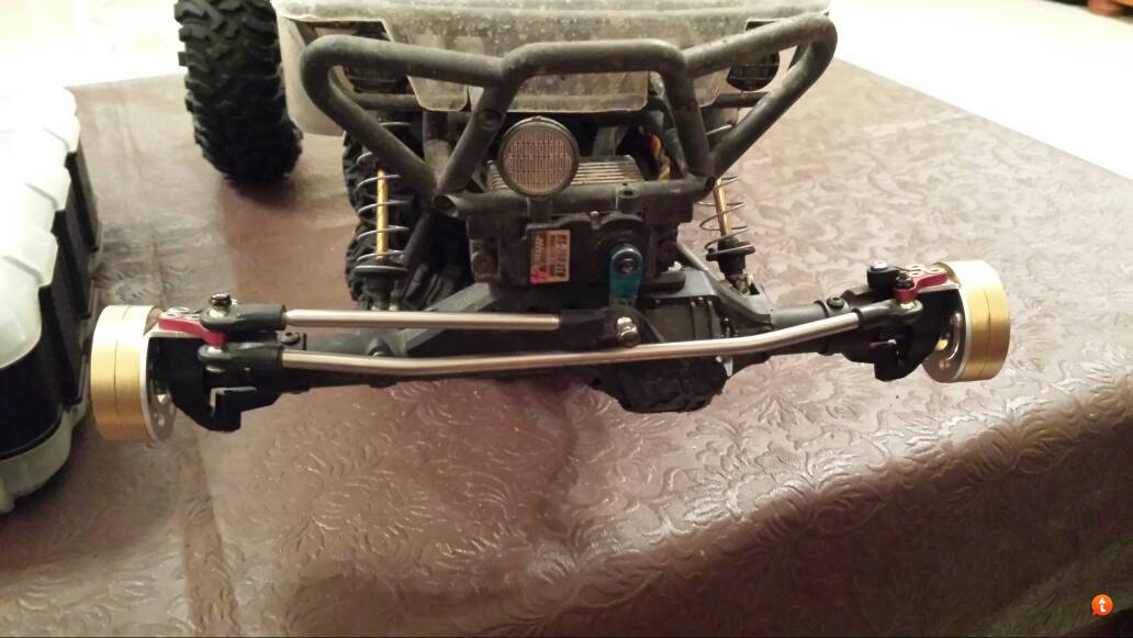

Edit: Just realised I also forgot to update on the latest wheel purchase and the upgrade to Vanquish steer links! Will get some images up shortly.

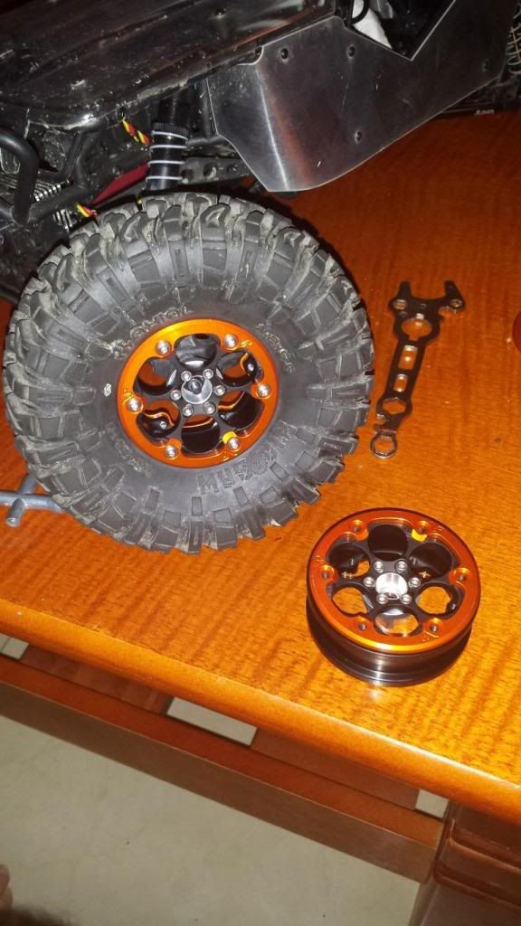

Wheels, beadlocks and SLW adaptors, ready for assembly;
Wheels slowly getting there;
One done!;
Done! Test flex;

Vanquish chubs, knuckles & weights fitted;
Current front end arrangement;

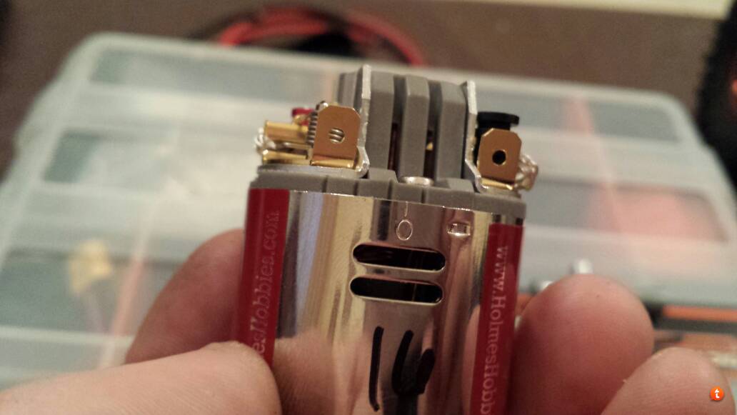

Crawlermaster 16t;
Which I timed at approx 6 degrees;
overheating is the cause of that, could be due to many factors, but running in water accelerates wear on the brushes, when they get worn down past a certain point they overheat rapidly and grenade the comm..also running all out alot will accelerate the wear and build up heat. The brushes are soft copper and wear fairly quickly if ran on the fast side of the trigger.
That has been my experience with brushed motors, since I tend to have a heavy trigger finger, I went to sensored brushless on my blue flame wraith and will be converting all my other rigs to sensored brushless as well..."thumbsup"
