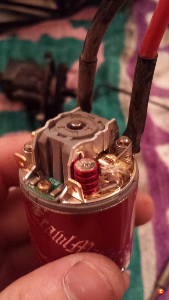

Forgot to mention that whilst the motor and it's brushes seem Ok. The unit gets very hot very quick. Specially if I am going over say 50% throttle.
Have not got exact temps but I'd say it's at the point where you can only just keep your finger on it without burning.
Already running 87/14 gearing and have my throttle trimmed to 80% of Max to keep top speed and heat down.
The servo also gets warm but not hot like the motor.
Should I be concerned about this? Or is it normal?

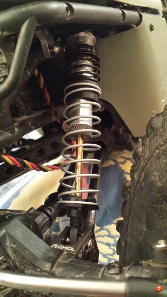

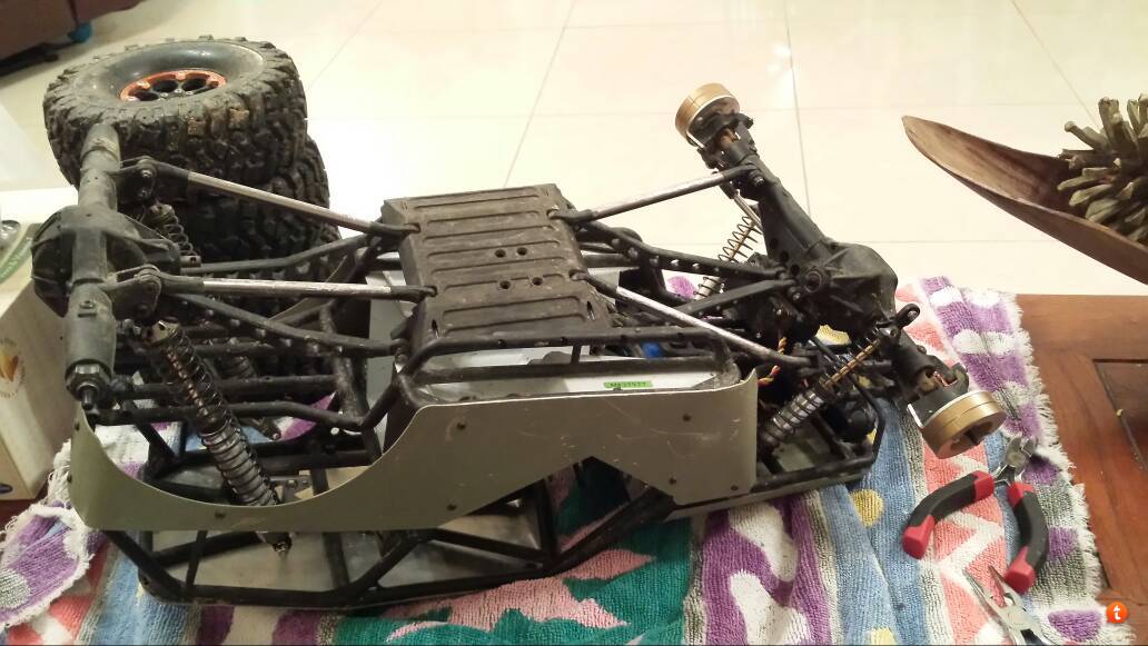

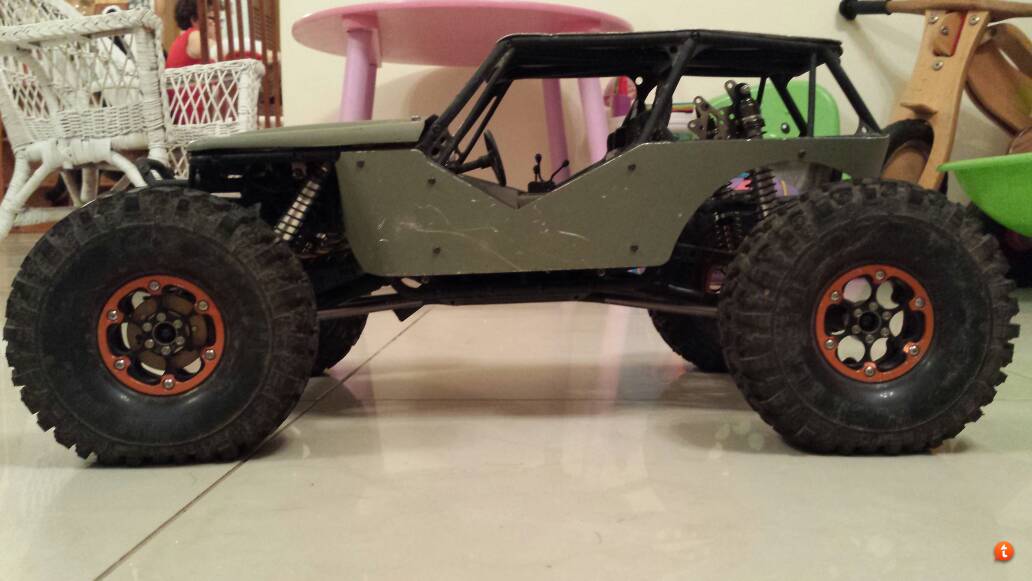

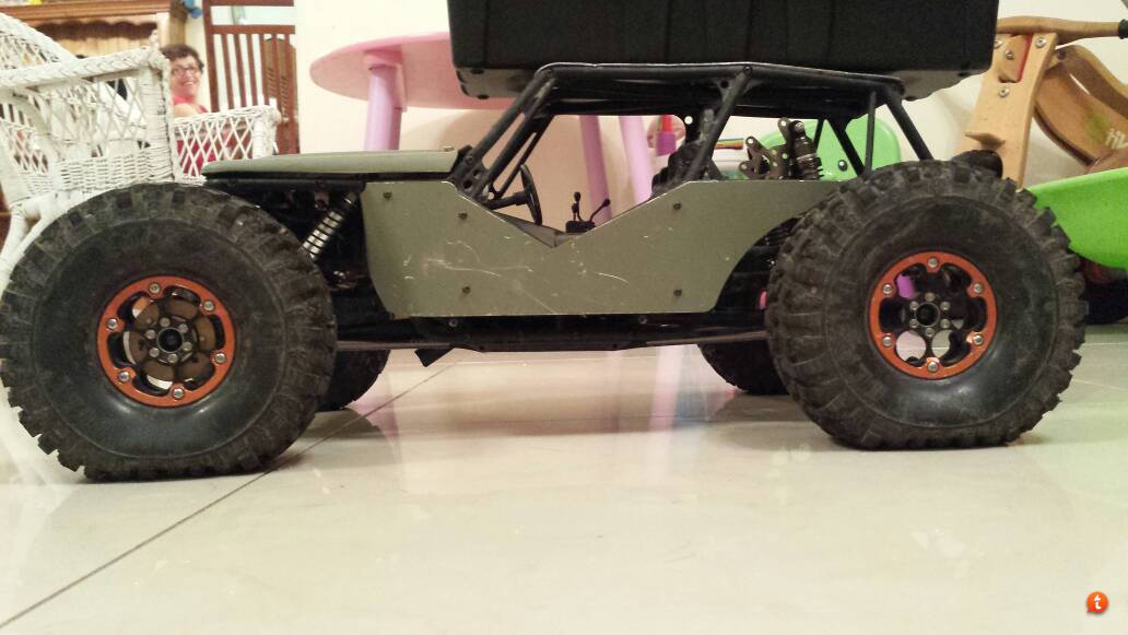

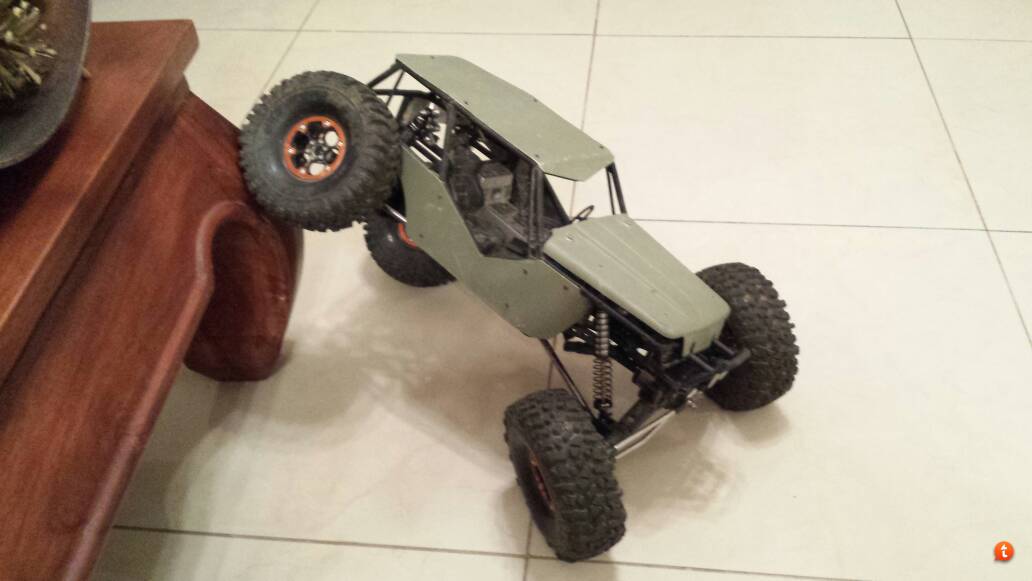

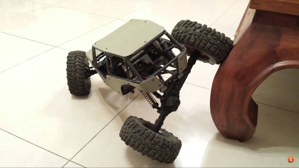

Level3 droop kit arrived and I have fit it this evening. Done something different in the rear to suit the 150mm shocks and surprisingly it works out dam well.

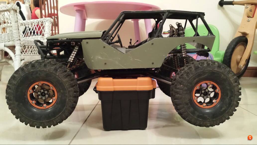

Current ride height;
Full droop;
Full compression;
The springs both front and rear need to be softer to suit my preference. But in saying that they seem Ok.
The flex is fairly even, the plan is to fit softer, shorter springs to allow both some preload adjustment and a slightly lower ride height.
At the moment the shock adjusters are wound right out.
I will then start experimenting with shock oil and pistons. But as it is a crawler is not to critical.

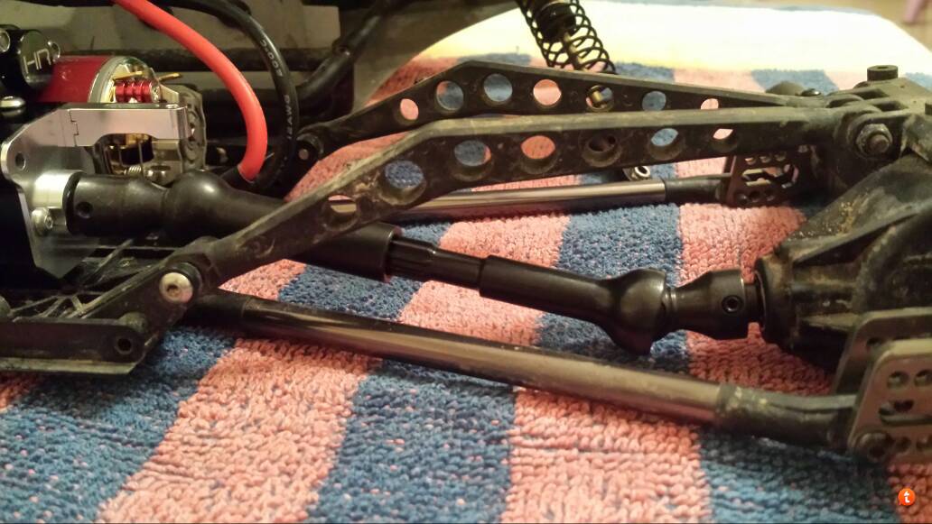

The configuration I utilized;
Front
Rear
Flex;
Looking good champion. I like how you got the 150's to work. Looks like you have same issues as i do now with up travel having the tyre lugs grabbing the chassis rail & loads up pretty bad. With the Bronco body on it doesn't grab & rubs horribly but due to the rear tub it eliminates the lug bounce on the chassis.
brooksy
Yeah I had issues with the front tyres binding with the outer wings of the front bar. I noticed you had trimmed them off also.
The other areas are ok. It doesn't rub hard if at all all in the rear and the front is manageable now with the wings removed.

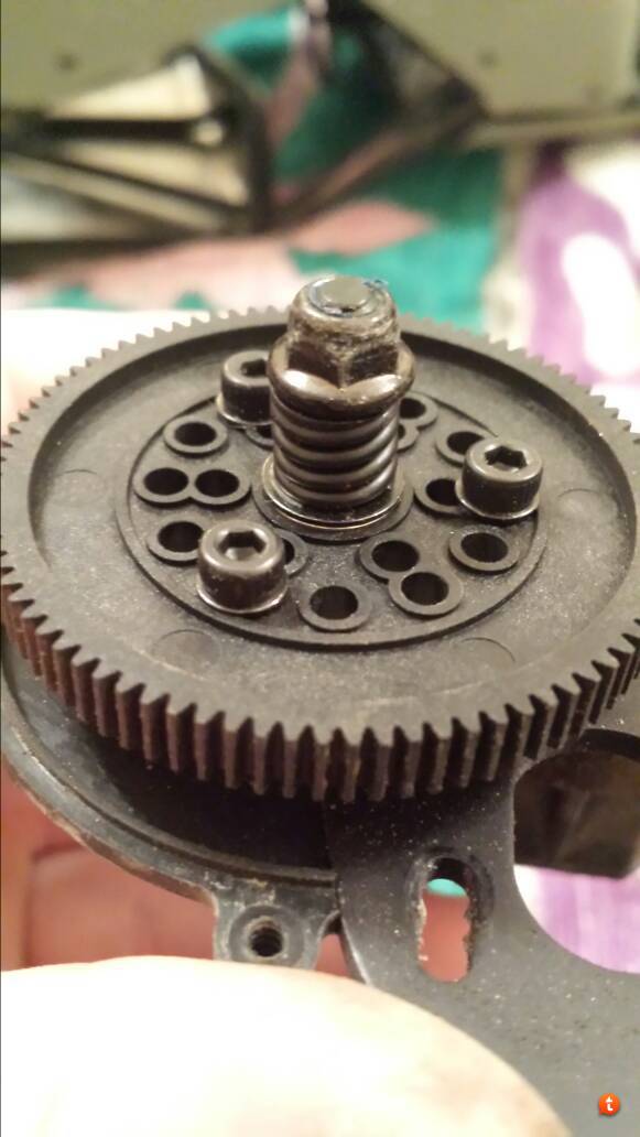

Now have what I presume is a stripped spur gear!
Yep, wraith is broken again :(
Meanwhile Petes stock PS Wraith is still going, even with all the high speed bashing! Think I might upgrade to stock! :)
Damn spur and pinion is fine;
Internals not so much;
Wraith is looking sad too;
But motor and brushes look like new! So that's one positive;
Looks like I'll have a few things to sort in one go.

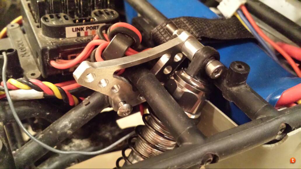

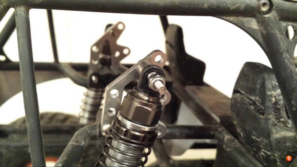

Part of my tower hobbies order has arrived.
First up the machined link mounts. Shock braces and a back up 55t motor.

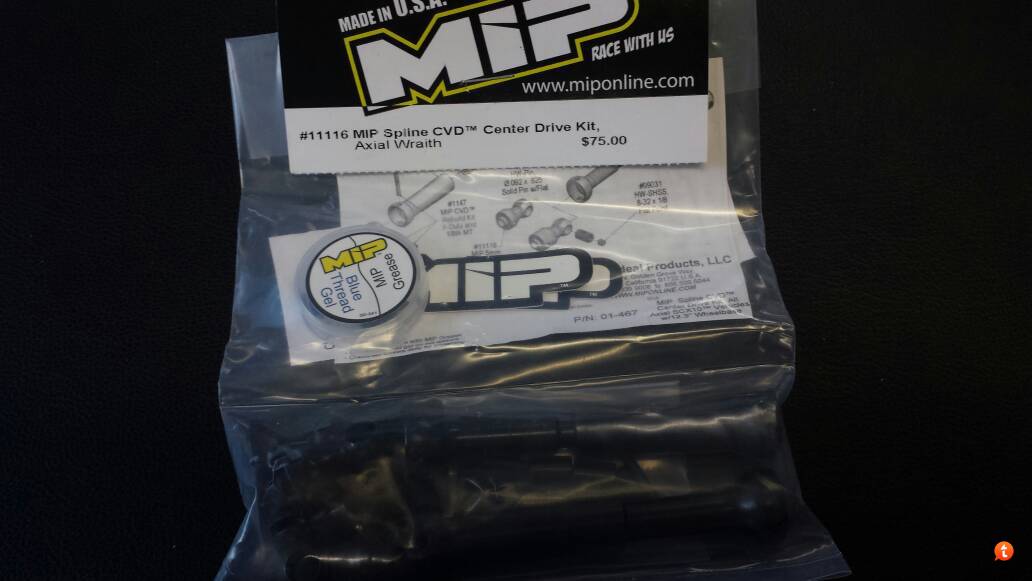

Next up the MIPs.

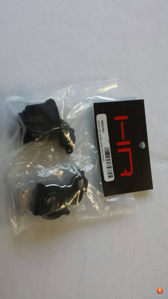

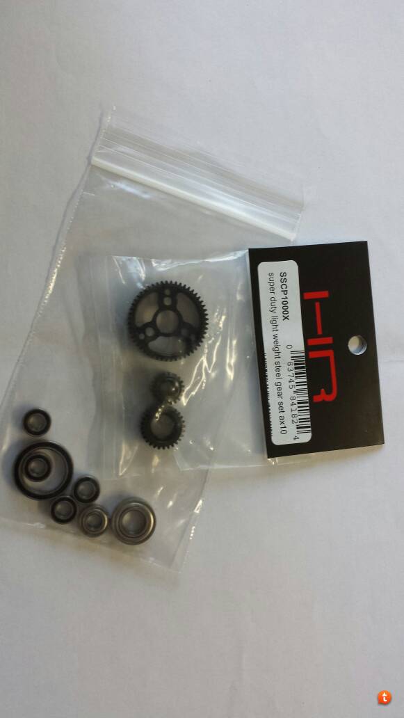

HR trans housing;
HR lightweight gear set and trans bearings;

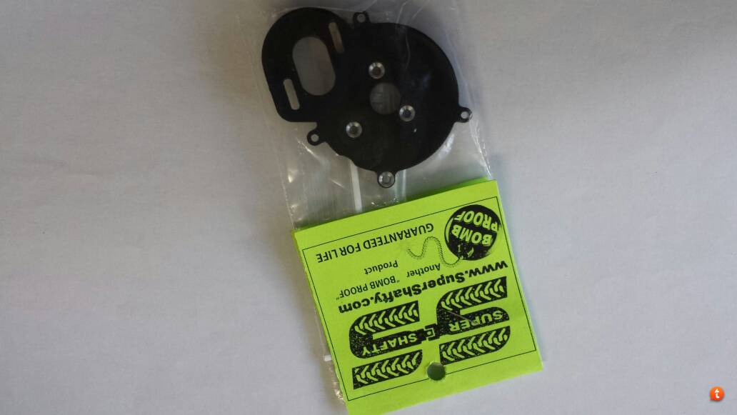

SuperShafty motor mount;

Hot Racing sux! Just like the HR products for the HPI Baja they need to learn how to cut threads.
I also need to learn not to try persist with shot threads. Cause I ****ed it further;
So I am putting the wraith aside cause nothing shits me more then the memories of all the crap HR and GH products that I never used on the baja due to poor fitment or crap threads in crap material.
Sorry for the rant. Why don't vanquish make the wraith case for use with the axial dig? I'd buy it already if they did!

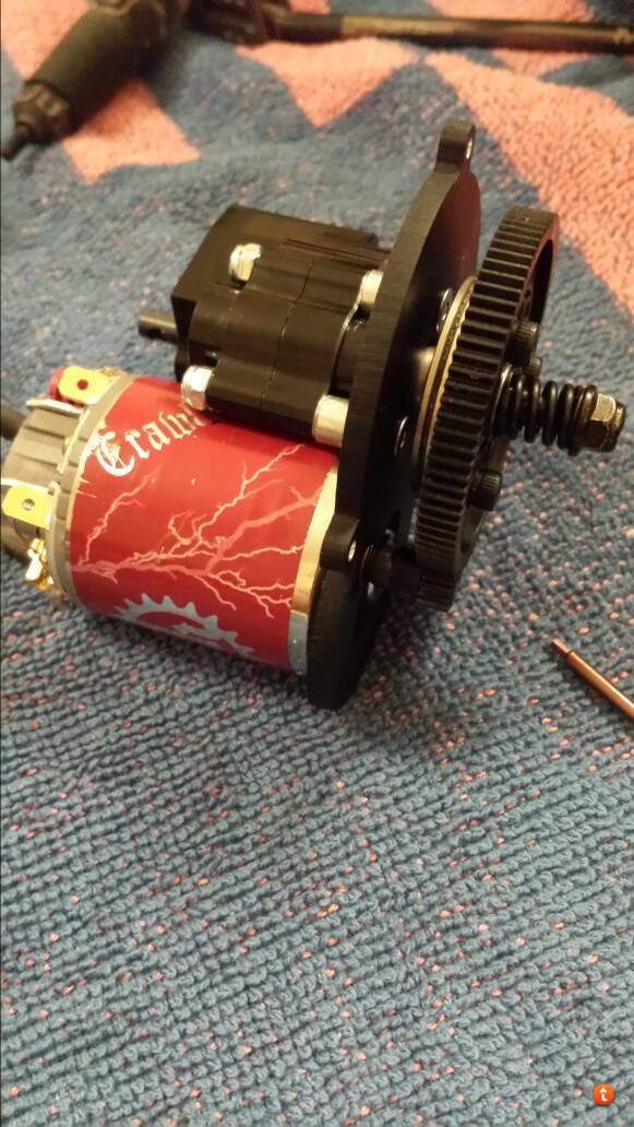

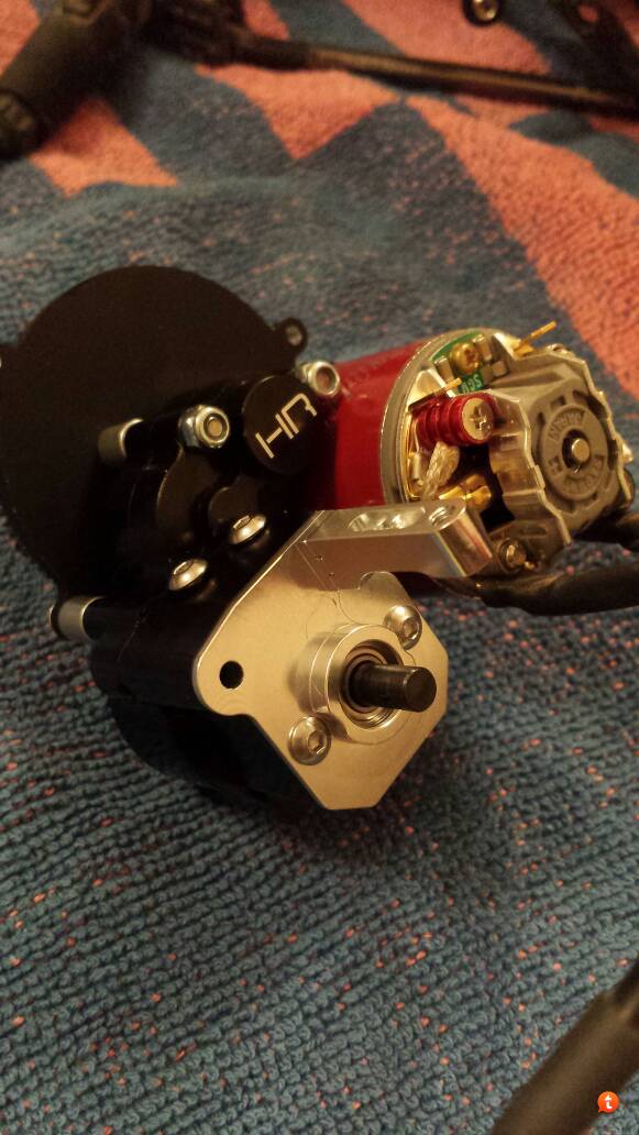

Ok calmed down over the weekend. Got a bottom tap (m3) today and have repaired the HR trans housing.
Fitted to the car along with the MIPs;
I do however still have a slight issue.

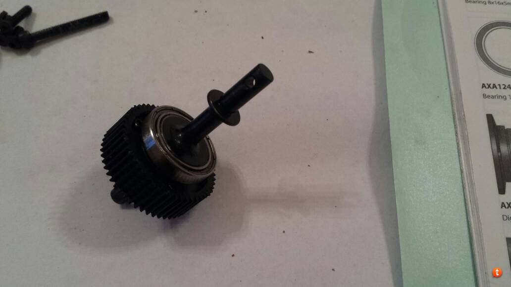

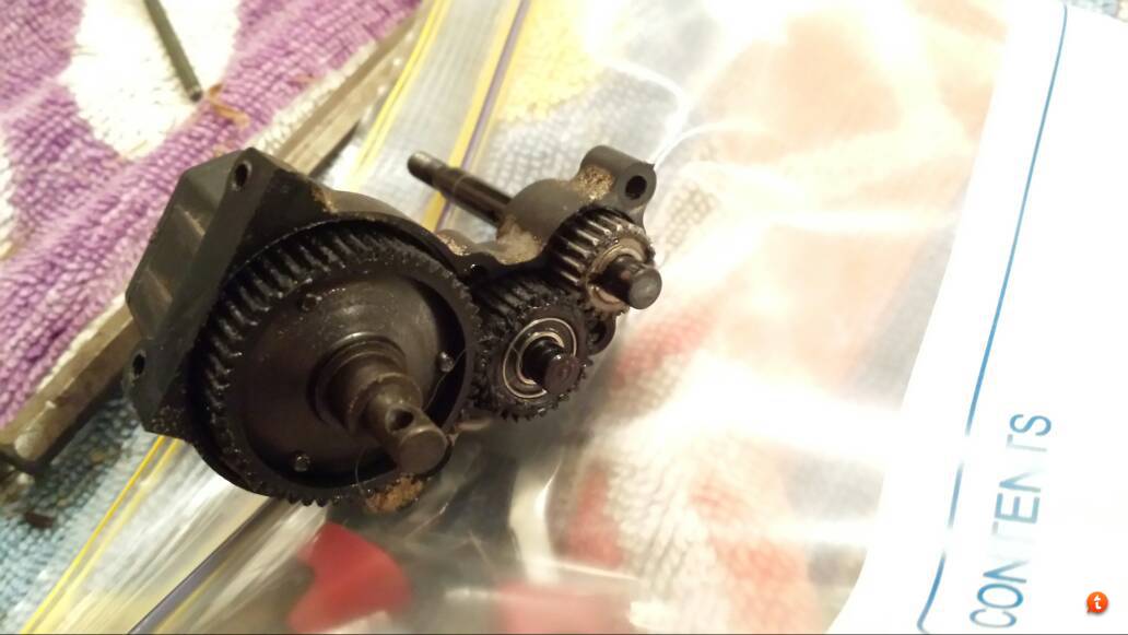

You see when building my kit originally I had huge difficulties getting this bearing onto the rear output.
Now I can not get it off! So all the trans gears have been changed but not the lower.
How does one suggest removal of said bearing and did anyone else struggle with the same during their kit build?
put it in a ziplock bag and put it in the freezer for a couple hours. then take it out and tap the shaft end that has the bearing on it, facing down towards a block of wood on a table or bench. Tap it fairly hard a few times and see if it will move..I have done this a number of times with success. tap the whole unit, don't tap on it with a hammer or anything.
As Allanon said. Same can be done with automotive wheel bearings for installing in rear axle housings.
Thanks for the suggestions guys. Will try this when I put the dig components on.

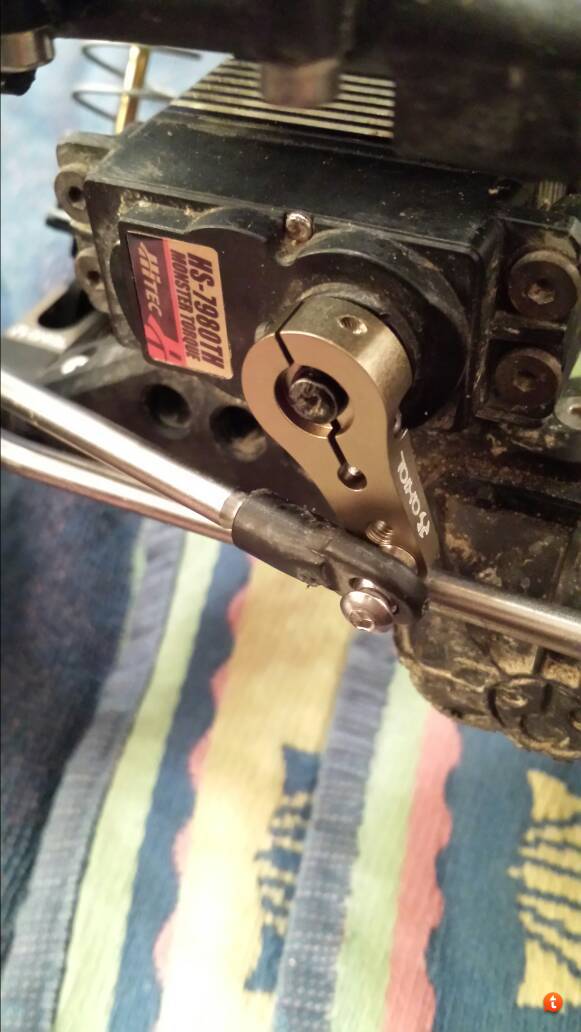

Fitted the axial servo horn this morning.

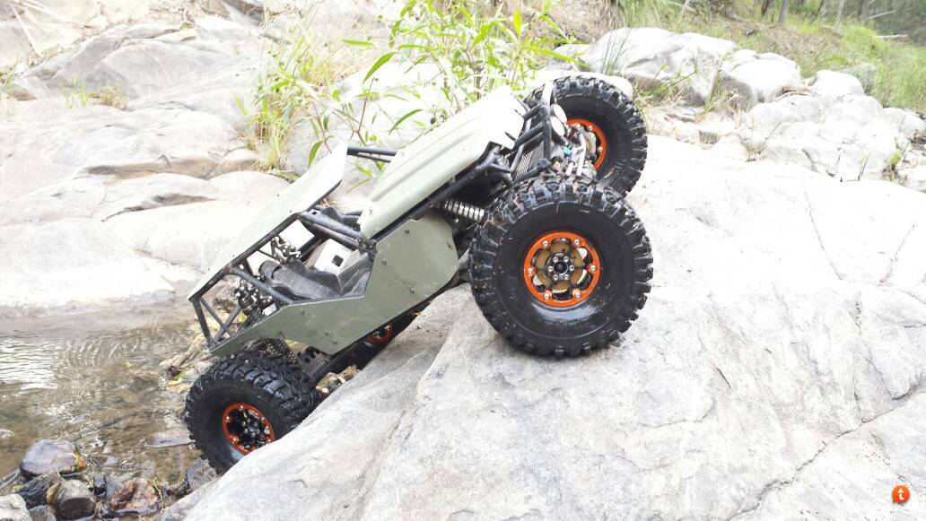

In the mean time here is an action shot of my POS at Coffs Harbour;
