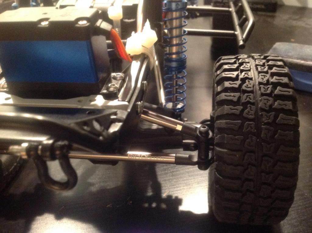

Did you take pics of the truck showing the problem?..if not you need to post some.
are those 2.2 tires?

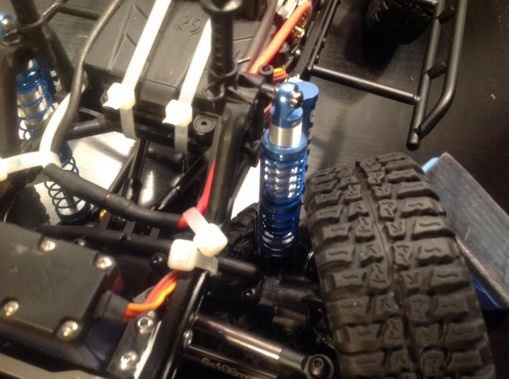

I actually like where you have your shock mounted on the shock tower but this is causing your issue with the tire rubbing against the shock.
move your shock in one hole towards the front and see if this gives you more clearance.
they are 1.9 dick cepecs, i think they are about the same size as stock... not big anyway. ill go check with the shock mounts.

ok,,if they are wider than a flat iron I can see them rubbing there,,,mine just barely and I mean barely by 1-2 millimeters clears my shock with my added steering and my shock is angled down much farther than you have yours..so it may be a tire issue for you in general.
I still cant tell you what the cms is doing to increase or even decrease your stock radius however if any.

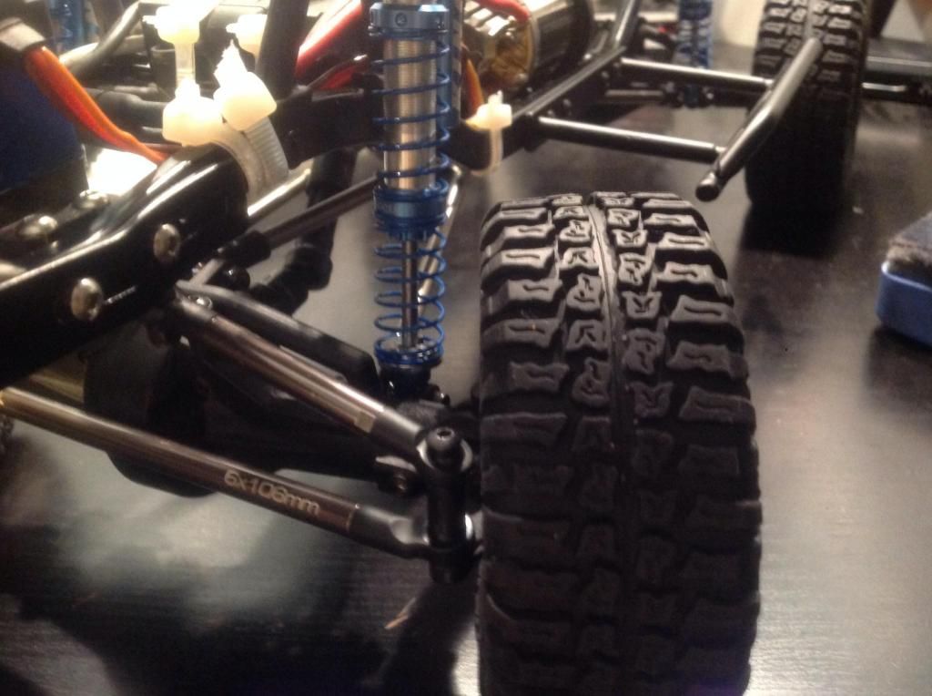

Well i can see its not oriented correctly to work like it should..the link from the servo to the knuckle should be more in line or parallel with the tie rod from knuckle to knuckle...it looks like its pushing more than pulling at that angle...
Rc4wd is a much better design....i will get better pics in a little while for you..my cms has no bumpsteer and turns as far as possible with the given stock design..
You fix the cms issue...your steering will be fixed as well...the cms is causing your issue
I think hes right bud..if you have links all out of whack you peeing in the wind...If your tires are stock width you shouldn't be hitting the shock like you are...I just noticed it hitting and thinking the tires were a lot wider in general and assuming the cms was correct....if your links are off you cant go any further until that is resolved.

right so, what? i get a whole new CMS? and for the links, what do i do for the tiny little gaps...? and I'm pretty sure the CMS doesn't affect how the tires hit the shocks. ugghhh this is so annoying. anyway, I will make sure that I fix the spaces in the links, and (not as soon) get a new CMS, if thats what your telling me to do.
