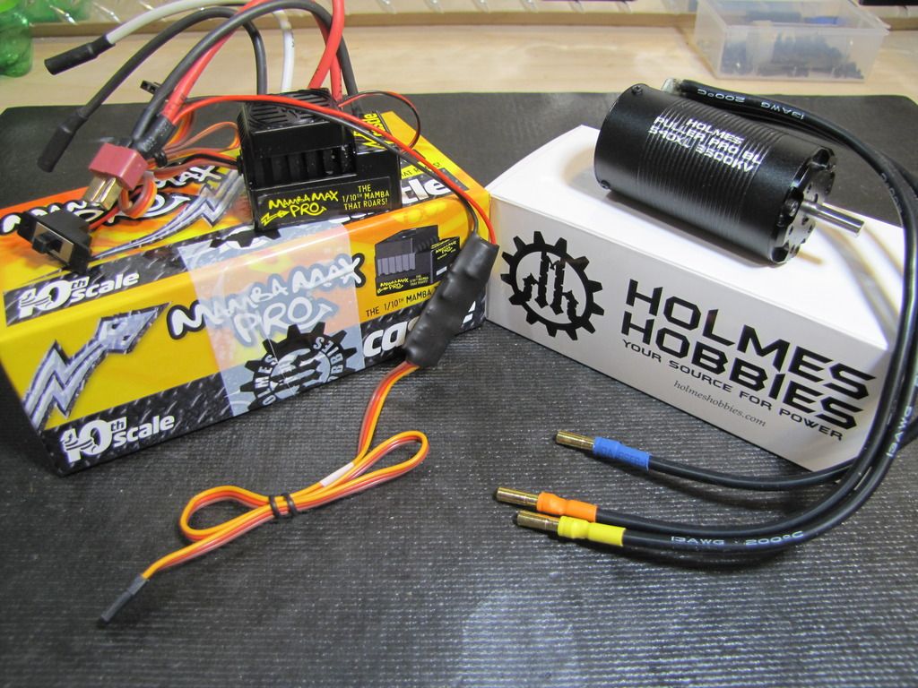

Got mine in the mail today!!!! I'm hoping to get pictures up for drooling purposes, but i think i actually have to get off my tired ass to take them first:roll:
So lets say.....to be continued"thumbsup"

OK OK sure I'm a little late with this, but here are the pictures!:mrgreen:

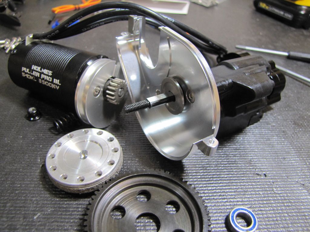

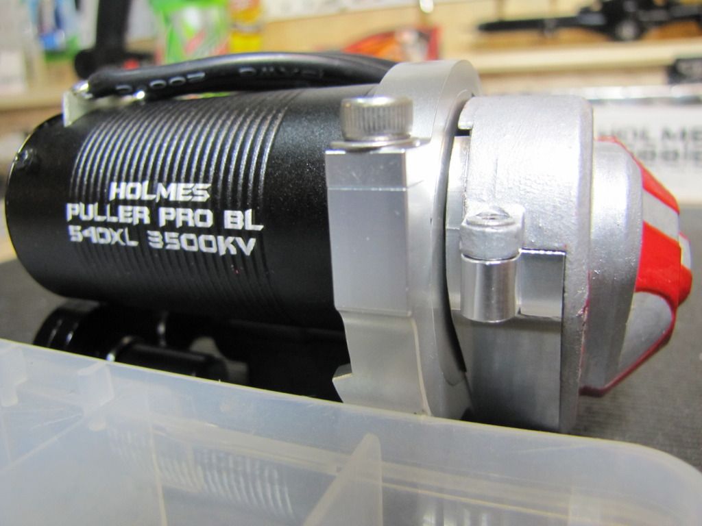

And a couple from the mounting:
And thats it until I actually get the Yeti re-built:oops:
