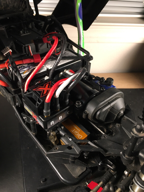

I installed the 540XL with the Mamba Monster X and omg!
What a difference from the RTR...
I ran for 10 minutes outside and I'm still questioning myself why took me so long to buy this setup...
Geared 15/64 have great final speed and still great torque, plus the 2 speed, I think even will be good for an eventual crawl.
Now I can't wait for next U4 race.
