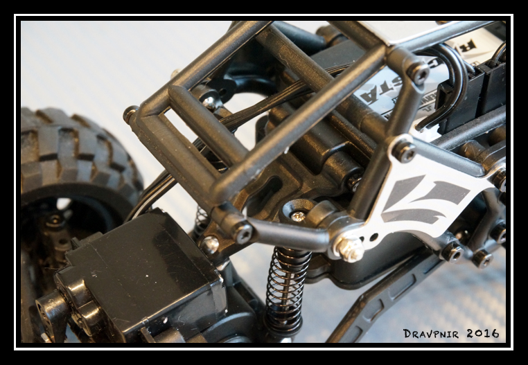

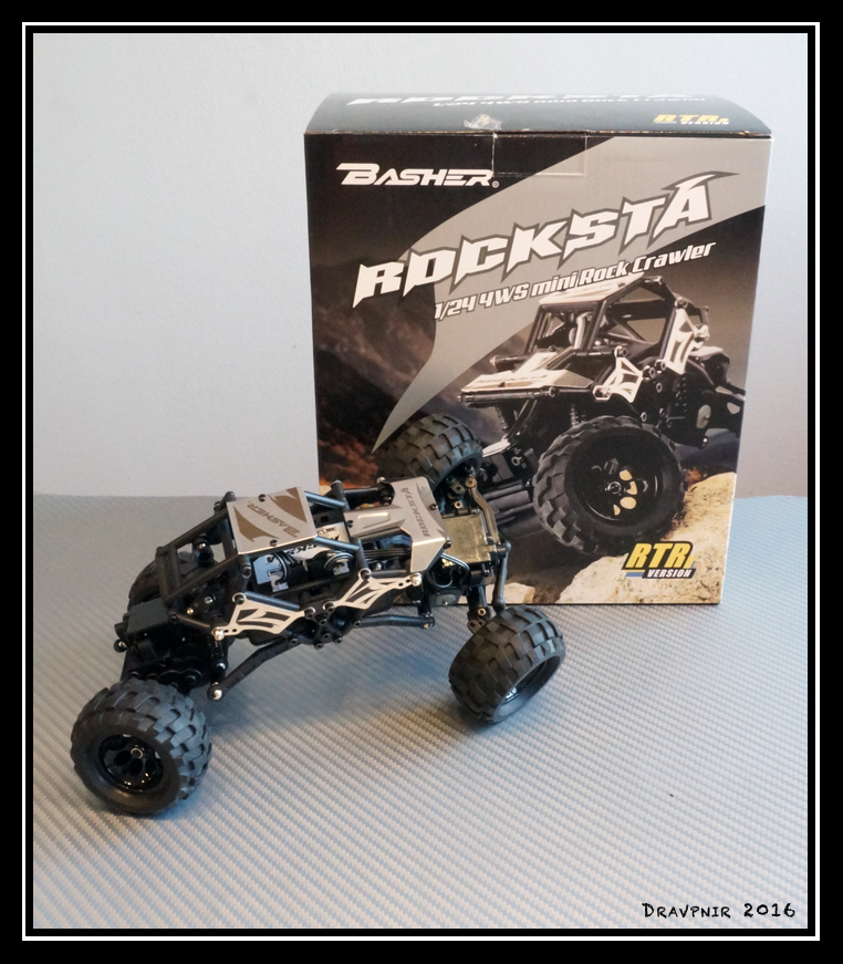

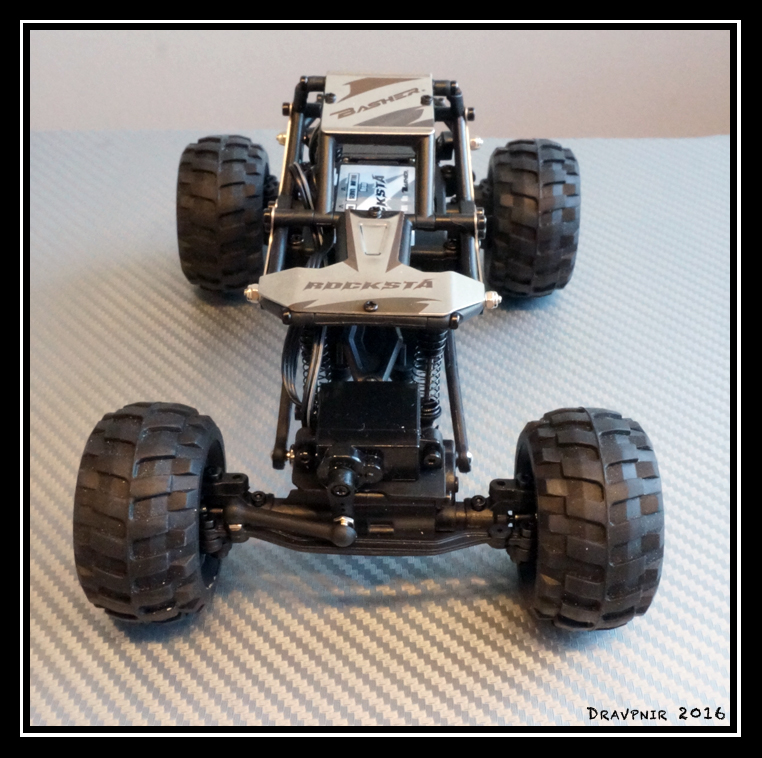

Last year I bought a clone of the Redcat Sumo Micro crawler and played around a bit with it. I never got really carried away with it but it was fun.
Then I saw the new micro crawler that Hobbyking sells, the Basher RockSta 1/24 Mini Rock Crawler. 4WS and MOA axles... for $66 I couldn't resist ordering one.
I choose delivery by DHL and I got it a little while ago

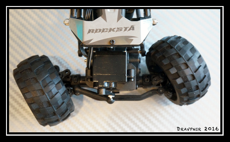

The steering is nothing to be proud of, but with 4WS it is livable and nothing worse than the Sumo.

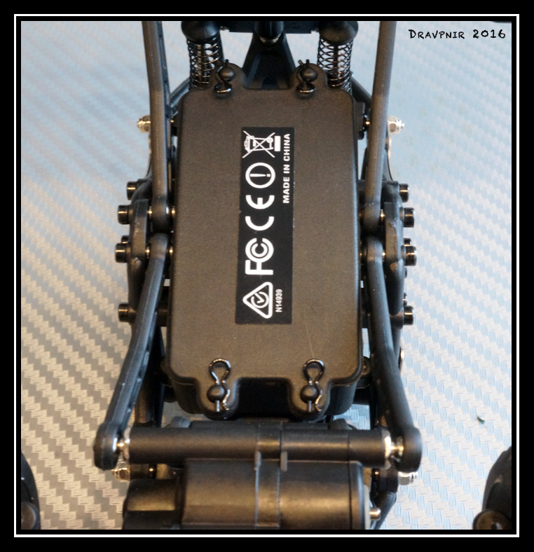

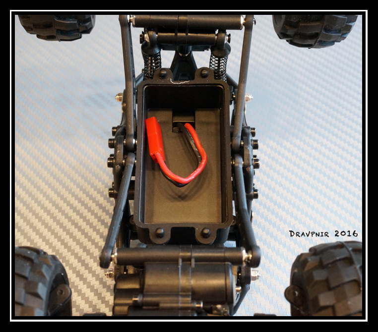

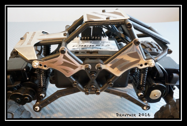

The main part of the chassis is occupied of the battery box with build in ESC and RX. I plan to exchange the stock electronics for 2 esc and a RX to really take advantage of the MOA axles.

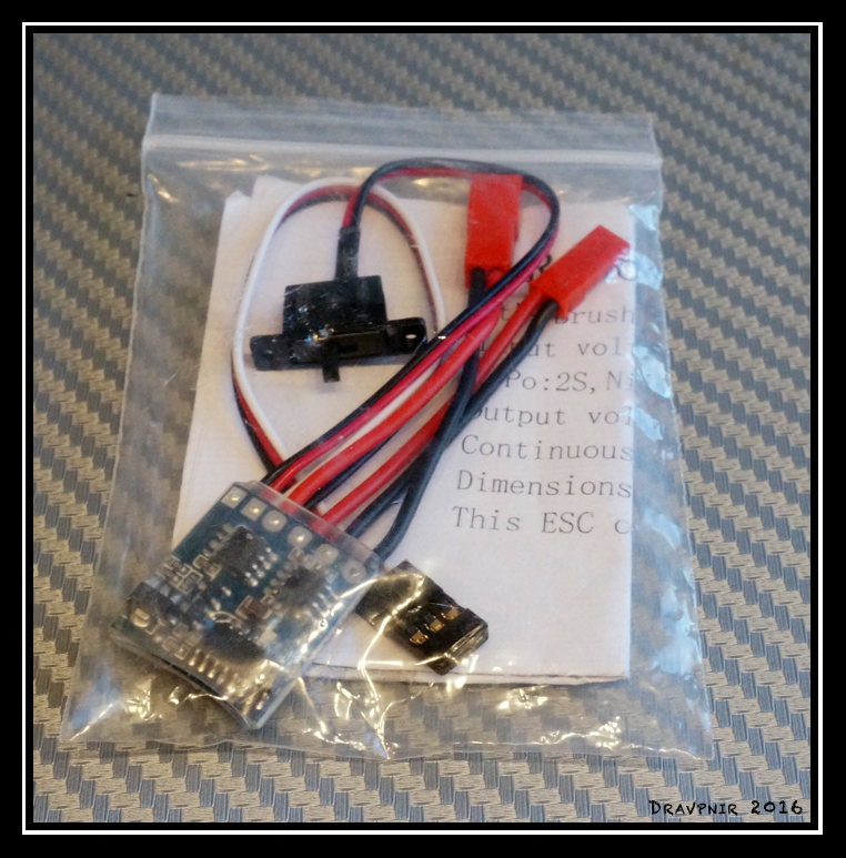

I got one of these cheep esc with break ($10 Banggood) and I have ordered another one. I hope it will arrive soon.
The battery is placed in the battery box from the bottom of the chassis. The hatch is removed but taking away the 4 small clips. There is a rubber sealing between the box and the lib giving some protecting from water and dust.

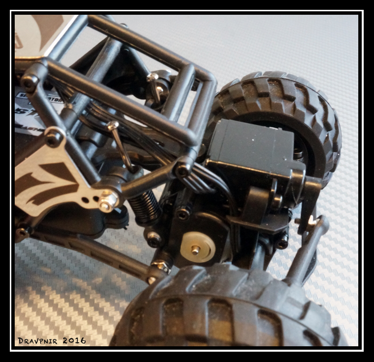

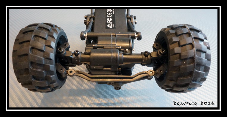

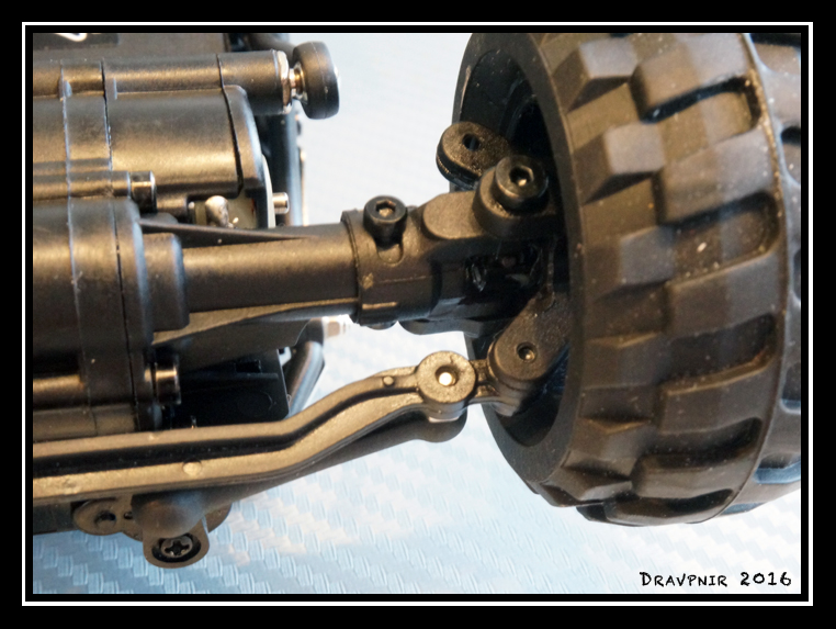

The axles looks rather good and are more compact than I had thought. I will take the axle a part later on to see how they look inside.
There seem to be possible to change the caster, like the Axial XR10/Wraith.

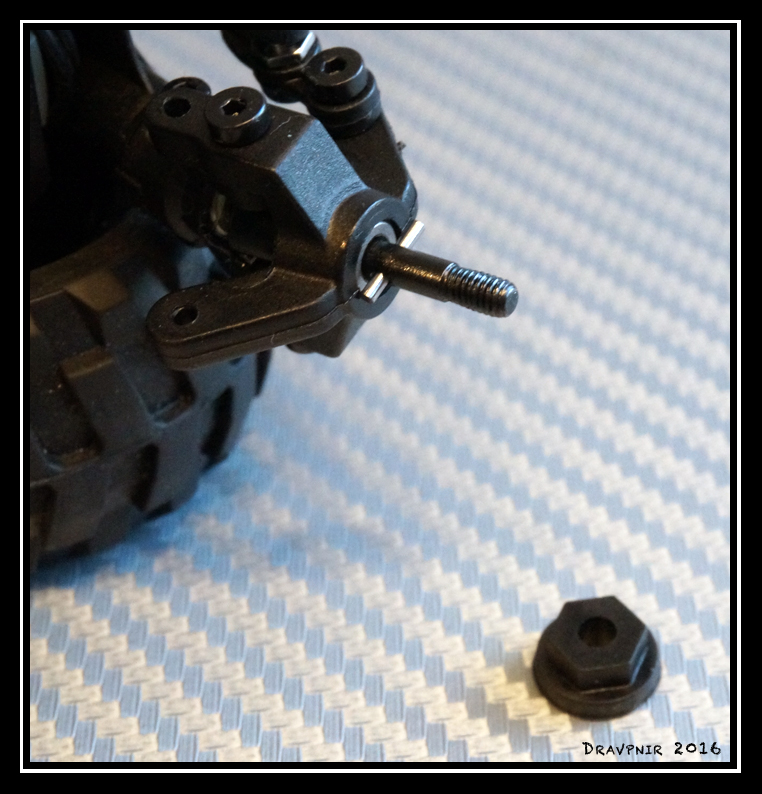

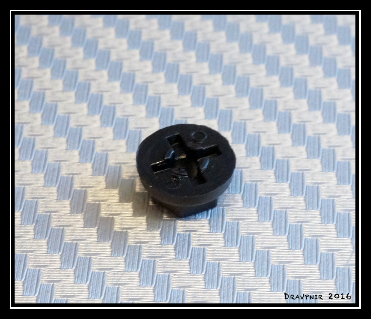

The hex is 7 mm like the Sumo. However, the axel stub is 3 mm instead of 2.5 mm on the Sumo
The hex also have two slots for the pin.
Unfortunately, the upper links are 3-links not 4-links
Something to fix later on...
The shocks are a bit odd, atleast to me. It is more or less just a rod that goes through a spacer that is fasten to the chassis.

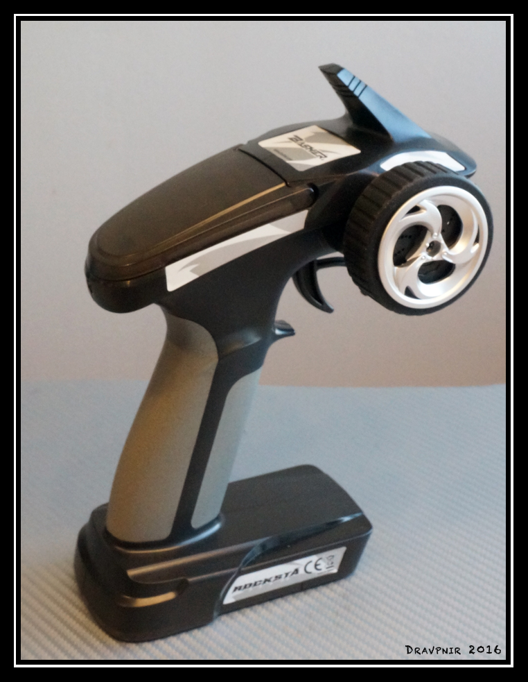

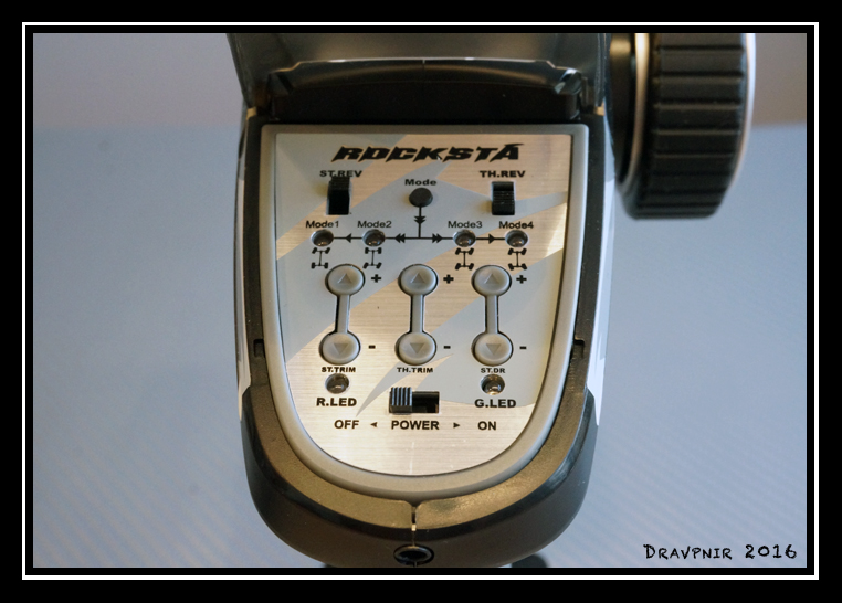

The TX is a standard cheap plastic one. However it is lighter and feels better in my hands than the Sumo one. It also has a short antenna which is nice. There is however two bad things about this TX... no adjustment of the rear steering. My rear tires are a bit off center at neutral... But the main annoying thing is that the button to control the 4WS mode is a small press button under the plastic lid! So stupid. On the Sumo TX the mode button is placed nicely at the thumb... Perhaps I will modify it and move the button so I can reach it easier.

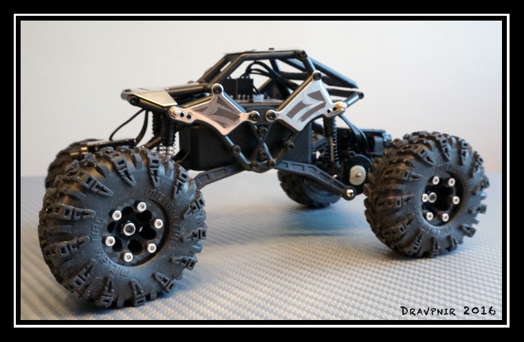

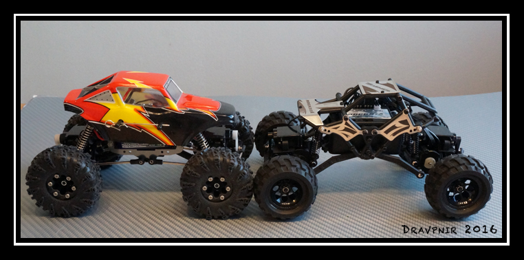

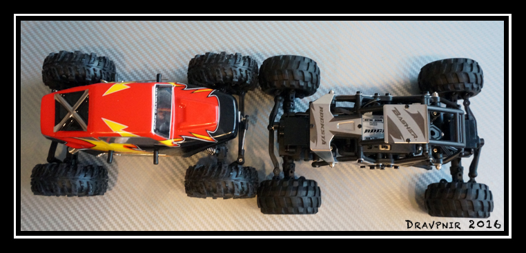

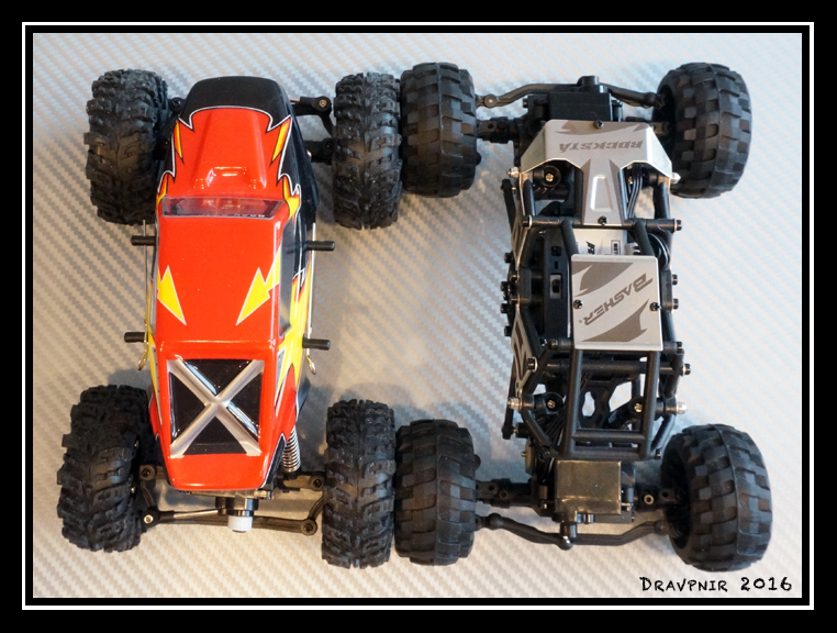

Here is some comparison pictures to my Sumo. The Sumo got some Miclaws on it with some DravTech Micro wheels that makes it a wider than stock.
Here is the RockSta with the DravTech Micro wheels and Miclaws. Looks much better than stock
After driving around with the RockSta on my couch I really like it. It behaves more like a bigger crawler than the Sumo does and the MOA axles opens up some much bigger possibilities.

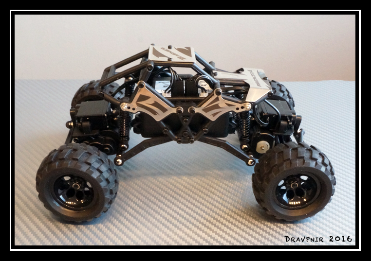

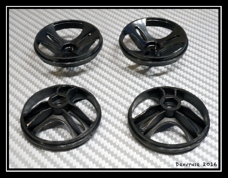

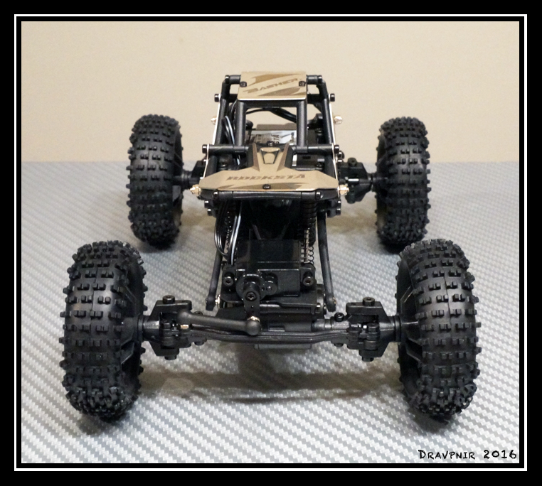

I found a nice youtube video by GamyRC that explained how to make some nice looking wheels for the micro.
Luckily Hobbyking had those tires and wheels, so I ordered a set with the RockSta.
I modified the wheels like GamyRC and glued on the tires. The glueing was a bit tricky and I am not happy at all how my glueing turned out. I think I will remove the glue and try again later on.
Here is a size comparison picture of the GamyRC tires, Miclaws, stock RockSta tires and the stock Sumo tires.

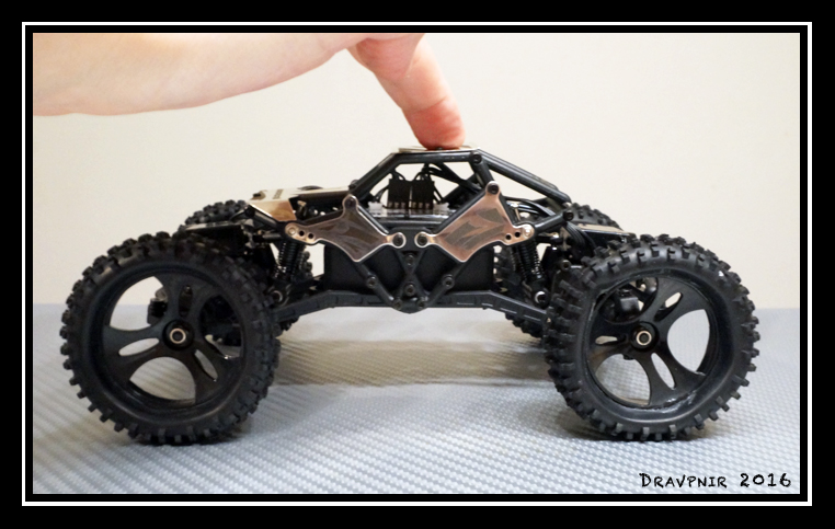

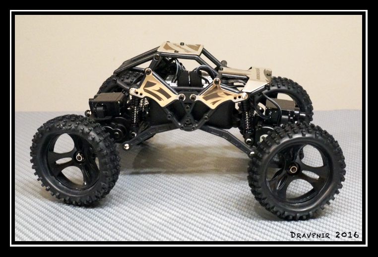

And here is the wheels on the RockSta. It gets a bit wider with this combo but the large diameter wheels really opens the possibility to use larger knuckles and perhaps even knuckles weights
I will compare how they work compared to the Miclaws.
This is the ride height I think I will aim for.

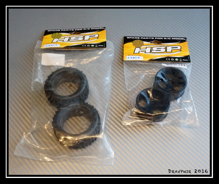

These are the wheels and tires I got from Hobbyking btw.

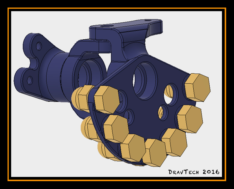

First of some new chubs to the RockSta that allow you to mount the shocks and lower links closer to the axle centrum than stock.
Perhaps also some similar chubs but that are designed to be used with MRC knuckles so one can use MRC drive shafts for improved steering. Or parhaps design new chubs and knuckles to get an easy way to mount some knuckle weights down low and use MRC drive shafts.
Of course a new chassis, I think it will be called SuDu SubZero.
Then lastly (for now atleast) some CF or printed wheels with a similar size as the buggy wheels. I really like the size of the wheels but I think the RockSta gets to wide with the modded plastic wheels.

WLtoys A959 1 18 RC Car Tire A959 01 Part for WLtoys RC Car Part 55F2 | eBay
Are these the same wheels your using?

Yes, I think so, but those comes glued so then you have to remove the glue first before you can mod the wheels.

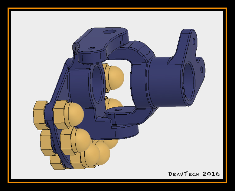

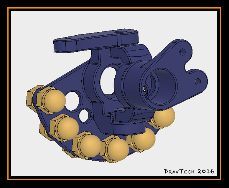

I played around a little today and I am almost done with some chubs and knuckles (with build in weight holder) to be able to use the MRC Pro CVD's on the RockSta micro crawler.
The knuckles has a steering stop at 43 degrees to protect the CVD's. The weights are brass hardware.

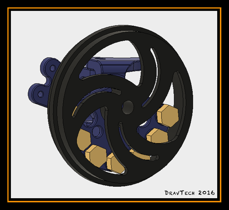

I also made a wheel in the same size as the GamyRC modded 1/18 buggy wheels. Mine makes the width a bit more narrow though.

Posts: 643
Default Re: Dravpnir tries to build something micro, again...
Quote:
Originally Posted by Inthablood View Post
I got my second esc from Banggood yesterday and I also got a few sets of those WLtoys wheels.
The WLtoys wheels/tires comes glued, but the glue is pretty brittle so it was easy to remove the tire from the wheel by just using your hands. One thing that was different though, was that there were no foam inside the tire. The HSP tires I got from Hobbyking were sold with a foam insert.
