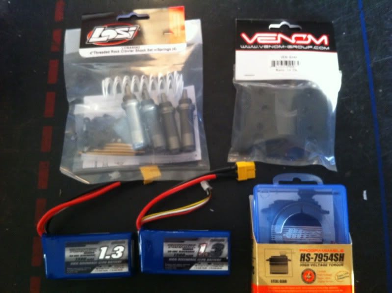

Got my first round of parts in yesterday. Shocks, skid, servo and batts.

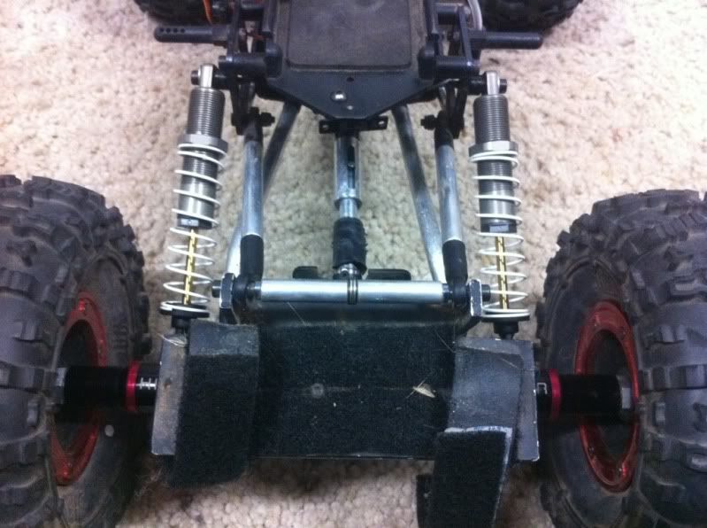

Stock chassis just is'nt designed for these shorter shocks, I lost a lot of articulation with them. Hopefully the new chassis arrives soon..

depending on how u have them mounted will determin articulation. post some pics of your setup, ill help u out. before the XR, i use to run a stock chassis with no battery tray and losi shocks. had lots of articulation when i had them setup right

Got the pics...
Here's showing max flex..
Mounting locations...I've seen people run the losi shock mounts attached to the chassis but again, not wanting to buy anything for this chassis. If I need to I'll make my own mounts for now but would rather not waste the time.

okay first things first.
basic:
  • take the battery tray of and put some bracers in there. it will help a ton with its crawling
  • move your upper rear links in just a tad. like move the 2mm spacer on the inside of the links to the outside closet to the mounting tabs to get some more rear trainglution.
rear:
  • mount on top hole of chassis
  • have shock 6mm of the chassis (put spacer inbetween)
  • move your links to inside the stock link tabs
  • mount shocks on outside of link tabs, closet to the wheels
front:
  • have the upper shocks in the top hole of chassis
  • move you to the inside of the stock link tabs (meaning put a spacer in the link tabs and put a shocks closet to the pumpkin or center of the axle)
  • now here u have 2 choices, u can mount your links to the in side of the shocks or inbetween the stock lower link tabs, that your choice
shocks:
  • i know on mine i rebuilt them and took some spacers that i found in them out to get a little more shock throw, id suguest doing the same for when running the stock chassis, if u did put anything in them
for right now thats all i can spot, but try this and see how it works
