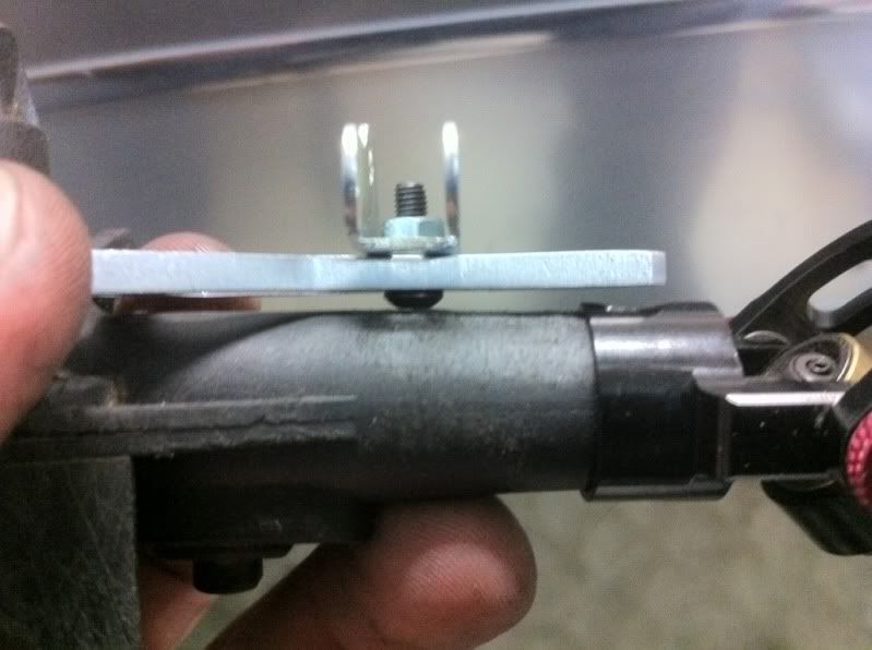

Quote:
Originally Posted by 28offroader View Post
Recieved the HR hubs and knuckles today. Great looking pieces...
But ran into a snag on install. You have to reuse your spacer sleeve from the stock knuckle. When I went to tighten down the knuckle to hub it would bind like crazy. Ended up having to add 1 shim inbetween the hub and knuckle. Did'nt matter if it was put on the top or bottom side. After that it was silky smooth.
Also started the truss installs. Got the rear finished but have a question on the fronts. The supplied button head screw holding the link stay on pushes the truss away from the axle housing. I'm wondering which way you guys are mounting the truss? Obviously your own supplied spacers are needed for the rears and fronts as well ,but are you guys spacing the truss far enough away from the axle for the button head screw clearance, countersinking the truss, or drilling a hole through the axle housing?
Or some other way I'm not thinking of?
I'm going to countersink the truss unless I hear of a better way of doing it before I install it tomorrow. I figure countersunk keeps from needing a spacer at the hub and keeps the truss closer to the axle for support.
Pic of what I'm talking about and am going to countersink.
Sent from my iPhone 4 using Tapatalk
I dont know how I missed this post bro...sorry...one of the thicker 2mm spacers from the Creeper kit will work fine behind the truss at the chubs...countersinking is fine though.
Ive been trying to find a decent 2mm spacer that is uniform in manufacture that can be included in the kit...and when I do find them theyll be added to the truss kit..
The last three sets of HR knuckles and C-hubs that Ive put together have had these same issues...I wind up grinding the c-hub ears down to allow the "top hat" to be put into the knuckle from the inside where it should be.
rmdesignworks is offline   Reply With Quote

Quote:
Would'nt it just be easier to countersink that hole? Or advise to do so? I seen creeperbob grinded on his front truss to allow for more steering clearance. With the truss sitting closer to the axle it would give that little bit more steering rather than being spaced out another 2mm. Or do you not want to do that for structural strength? Or another reason that's flying right over my head, lol.
Quality control over at HR must be nappin...

Old 03-11-2012, 10:51 PM   #94
Join Date: Jan 2006
Location: ...the burning end of the rope.
Posts: 5,013
Default Re: 28's Creeper
Try adding another ounce to each front for a while and see if you like that better..your forward bias should be right about a 1/4" forward of the trans skid plate...front edge of the skid is good too...you may want to add at least a couple ounces to each rear or to the axle housing so you can try the difference on some different lines..
Not everyone has a countersink...I do of course but I am leery of CS each front truss for those two holes that line up on the axle tube...additionally...a spacer between the truss and c-hub only takes away about 1* of the steering..maybe 2* but thats not that much. I have redesigned the front trusses to alleviate these issues. The original design had the spacer in mind and my axle has had spacers from the start. The original design also called for milled link blocks though that would have allowed for CS the trusses without any strength issues.
Old 03-11-2012, 11:09 PM   #95
Join Date: Jan 2011
Location: murrieta
Posts: 280
Will work on the weights and post up my findings.
Yeah, did'nt think of eveyone having a countersink bit. I'll be watchin your thread for the release of the v-3.
28offroader is offline   Reply With Quote
